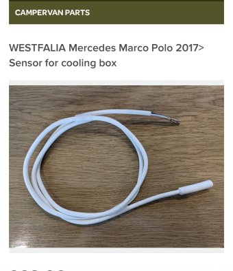

Re point 2. It’s a common failure the temperature sensor fails. Replacement is about £75 (Mercedes or Campervantastic) the fridge is an Dometic unit made for Westfalia. and DIY replacement is fiddly but OK if you follow YouTube link of a German guy. I’d just cut the sensor lead and join in an easier access area with small WAGO type connections.
