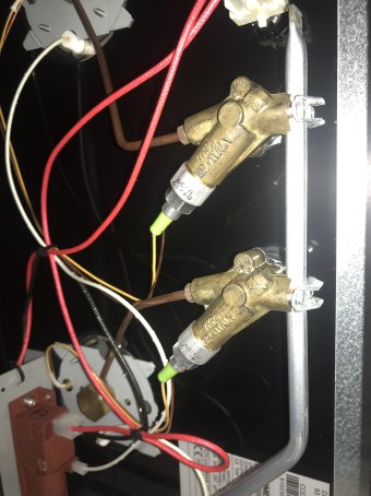

At the hob end this involves removing the top rings on the hob - easy, and then gently turning the thermocouple in a circular motion back and forwards. At the valve end, you need to remove the drawer below, then the metal plate (4 screws), and then twist the 2 cables around back and forwards as they go into the valve (pictures below).

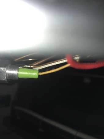

This photo is the 2 valves from below, the 2 cables (brown, yellow) go into the green plug which you rotate gently back and forwards.
This is the same plug with the brown and yellow cables which from the side, the cables go between this control valve and the underside of the hob/thermocouple, which you twist back and forwards:

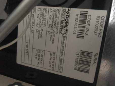

And this is the model number of my hob - can be used to find the Mercedes parts diagram which is a little confusing:
