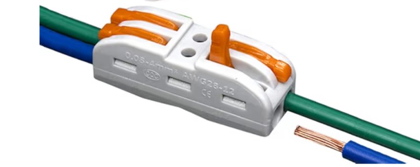

Rob & Sandra Active Member Yesterday at 6:16 PM #5 Litterally did this today. Got my sensor directly from Dometic UK. Used small two way WAGO rather than fiddling around the back of the unit.
