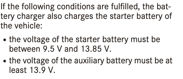

I went to the van to get the windows open to reduce heat in these hot weather but I somehow forgot to remove the car key....as a result, the starter battery went completely dead. I'm now plugged in and charging the van as the manual says the auxiliary battery and starter battery are linked so the starter battery can be charged when you are charging the auxiliary battery. The dashboard has no sign of life at the moment so hopefully it will make a difference overnight. Has anyone actually experienced this and can confirm the starter battery can indeed be charged when you are charging the auxiliary battery?
