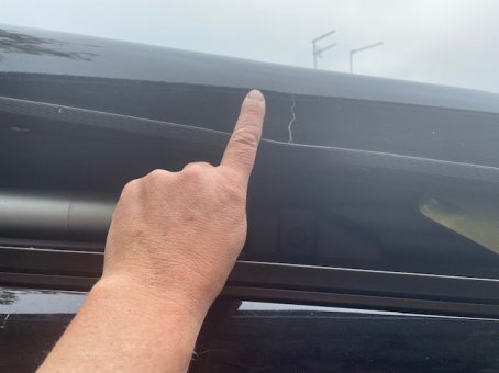

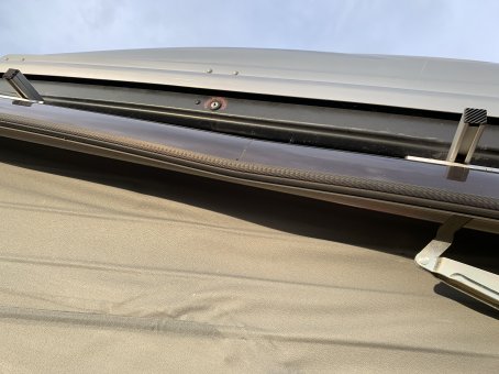

After raising the roof to do some pre trip cleaning, left the top up overnight then in the morning came back to this! On the outer lip of the roof the grp just seems to of pulled itself apart. 2017 MP, nothing obstructing, not hit anything. Clearly im horrified. Any one had a similar experience or any suggestions?
I have not seen or heard about this issue before. Plenty posts about blisters but a cracked roof is news to me. Clearly this is either a manufacturering or assembling problem. Hope you will get some resolution from MB.
Sent from my Pixel 5 using Tapatalk
I saw someone on FB had a similar issue, but the crack was larger...my inclination is to think that the roof remained "caught" by the catch at the front whilst the hydraulic rams pushed up at the rear....but this is just a guess, I have not experienced this myself.
Thats a first for me, can't help but having had fibreglass slalom kayaks in the early 80's they take some abuse before cracking. I know its 2017 but worth talking to MB as that looks like a major failure.
I would consider skipping talking to your local MB dealership and head directly to MBUK, the contact we have been given at MBUK for the roof blistering issue is "Harry Clarke" if this helps
We have located at least one other 2017 owner that this has just happened to in exactly the same way. This is ours.
That is worrying; blisters are just something that's annoying and isn't acceptable on an expensive vehicle, you have the choice to repair or leave it. This is a roof replacement necessity and most probably out of warranty.

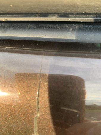

We have literally just had exactly the same happen to our roof yesterday (September 17th 2021).
We have a 2017 Marco Polo, registered in March 2018, which we have had from new. Our roof had a roof box on it at the time, but the weight of the box and contents was well within the 50kg limit.
I spoke to our Mercedes garage who said they would just refer it over to the Mercedes approved body shop nearby, and that it would require a new roof. Mention was made of them having referred one like it before, which at the time I chose to remember but not comment on. They cannot have sold that many Marco Polo's down in Cornwall, so if ours is indeed the second one that makes the situation feels like a definite Manufacturing fault/problem and not a consumer problem.

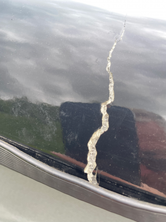

My 2017 MP has also developed a crack in the roof, specifically the nearside (LHS when looking forward) roughly where the lifting arms meet the roof, roughly in line with where the rear C pillar is.
When I look closely I can see lots of small vertical hairline cracks developing just under/around the seal area.
And of course the one major crack you see in the pictures below, this is taken with the roof half open, the crack reduces to a hairline when closed.
Thankfully my roof is already authorised for replacement due to the paint defect so not a biggie for me.

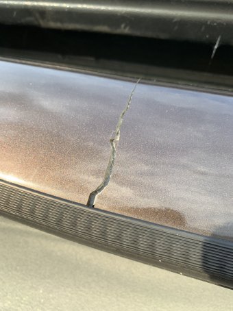

Hi Pete, yup this looks exactly the same. We have been unable to make any progress to be homest but have located one other MP via Facebook that also has this issue. Luckely for the owners Merc authorised a repair as they had an extended warrenty. I tryed Westfalia, they were not interested and told me that Merc did not let them talk to owners. I took the vehicle to the supplying dealer, they took pics and tryed Germany. Germany, refused to entertain the idea stating that they had never seen this before and that it must be due to user external actions. I then went to Merc customer services, who pretty much said the same thing but offered £ 125 off the cost of an authorised repair!! Its the classic 'we are only interested in your money' play. Its very difficult getting any where without proper contacts. Ive investigated getting the roof repaired but dont have any costs as yet- the roof has to come off so its going to be 000. It would sence to have metal rods embeded into both sides into the GRP, else i'm fairly sure a cosmetic repair will yest again pull itself apart. There is also an issue of using the cracked roof in high wind- as it wont take much to rip it apart.

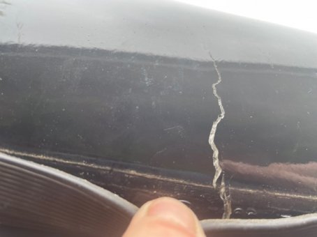

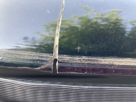

As planned, I spoke to our local Mercedes approved body repair shop and they confirmed that they've had a number of these from the Mercedes dealership in Exeter to repair to date. They have said it is a defect and a warranty repair (however I assume those vehicles were less than 3 years old).
