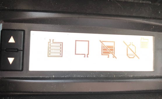

Thanks GT, Yes it is a 2019 MP and has recently had a new control panel fitted. I have downloaded the app but haven’t found a reference to the symbols with a slash through them though the waste water tank is, as you say, the 3rd one along. Our tank is nowhere near full.MIC - am I correct that you have a 2019 MP? - have you tried downloading the MB Guides app? there is a specific guide for the V Class with an MP appendix.
So just the "hot water bottle" icon to sort....just as an aside, if you have had a new control panel fitted it could be related to the fault readings you are getting on the panel or is it just a coincidence?, did the fault codes just appear? Is there a fuse issue maybe?...we'll track it down one way or anotherI have now found reference to the waste tank symbol in the online manuals library Marco Polo supplement.
The slash indicates that the level sensor is faulty.
