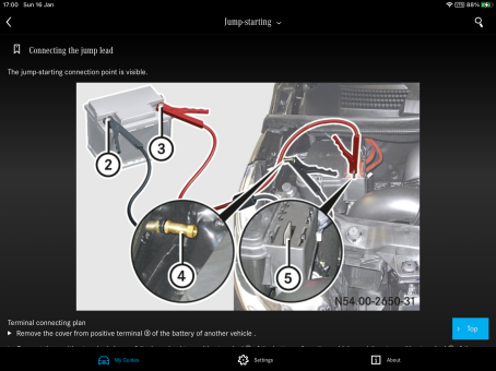

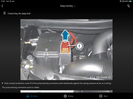

I have attached photos from the online manual for the battery connection under the bonnet. However this is for jump starting the vehicle and does not charge the leisure battery.
If you have a Marco Polo use a hook up cable to connect the vehicle to the mains supply. This will charge the leisure battery once the main vehicle (starter) battery is charged. Alternatively you could take the vehicle for a run.

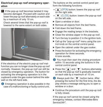

....The manual refers to a button behind the cupboard under the burners. Now I cannot figure out how to get to it or find it so that I can manually lower the roof. Has anyone actually found this button or have any other bright idea as to how I get the roof down in these circumstances? ...
The emergency button is in the cupboard under the gas burners as you say. Are you saying you don't have one?
Does this help or have you already seen....
The button should be there but it is difficult to find. When I first had my MP I printed off the instructions that SteveR has posted above and left them under the cutlery tray. I also checked the emergency lowering procedure actually worked.
