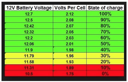

If you discharge the battery below 50% SOC it can cause damage and shorten it's life.
10.5v is 0% SOC a dead battery that may well never recover.
All voltages are at rest, no load for 1hr.
