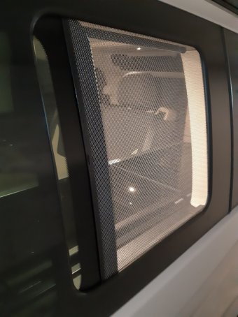

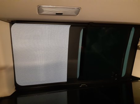

I cut a steel grid to the exact shape of the sliding window and added a plastic frame around to avoid finger wounds while putting it in place.
To insert, you open the sliding window to the max, place the steel grid and then close the window until the first locking position.
