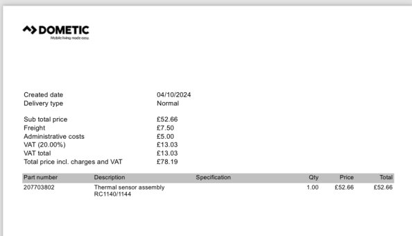

Hello.
Just a quick Update no did manage to get answer from Dometic directly. Westfalia no reply, Merc dealer none committal.
See attached quote
Dometic UK Customer Services
