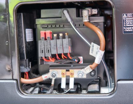

For reference the leisure/starter batteries are accessed by pulling the side panel/pocket off the driver/passenger seat.
This is the leisure Battery, the starter is similar.

I pulled the leisure battery out and found the answer to question 3. Right at the rear of the battery compartment is what I believe is a split charge relay, showing a positive connection from each battery. No B2B charger.

It is not necessary to remove the seats. You can replace the batteries and work on the cabling around them simply by removing the plastic cover (pull firmly and it pops out).
Left side cover removed:
Then you simply remove two screws (see pic above, two screws that keep the black metal battery holder in place), move the cables aside, and pull firmly the battery out. It is heavy and will take some effort.
The following picture show the battery tray empty. It is not a large space to work in, but certainly much easier than with the battery in place :)
The right hand front seat is the same, but contains the main battery (for the engine).

@enano I've removed the battery but it's not possible to remove the VSR without gaining more access, at least I can't do it.
Hi Samebutdifferent,
It is possible, 2 plastic nuts at the top of the relay and then you have enough space to unscrew the red cables. I did it on the way in a parking lot in 20 minutes.
