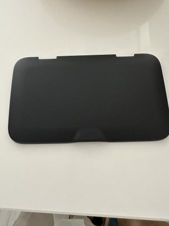

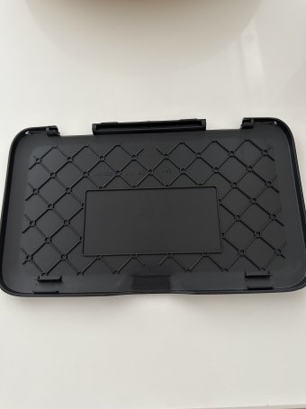

I am at my wits end with this as the company who I purchased the mp off just over 3 weeks ago (fault discovered 2 days after purchase) Anchor Vans Reading just sent me a new 'flap' in the post and told me to fix it myself! it was easy apparently - that took 10 days to arrive. I am now discovering that purchasing a vehicle 4 hours drive away is a real problem because no one around where I live will fix it - so I am going to make the drive down with the part and ask them to fit! definitely a lesson learned by me, although my Mercedes dealership did say that people do that all the time!

All that holds this in place are two pins. Get yourself a thin nail tap both out and pop the new part on. It’ll save you a trip and take less than 5 mins.

unfortunately one pin is lost and I couldn't get the other pin out - I also think the small spring is broken inside where the pin sits!
