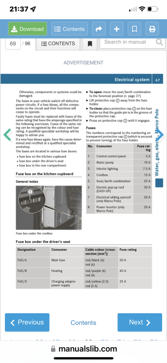

could it be that the fuse has blown, fuse 6 (from looking at the manual) protects the electric pop up roof. Maybe it’s become dislodged? My logic is that of that circuit has failed then the control panel will not detect the circuit and not display that function.

Good Morning, thanks for all your help. The voltage is showing 13.4v. I will have a look at he the fuse this morning.
