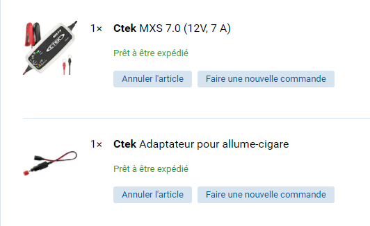

Thanks!!! just order itYou can plug a charger into the 12v socket in the van. Many chargers have the accessory plug required like this one from Ctek

I've used the 12V socket battery charger and it worked!
