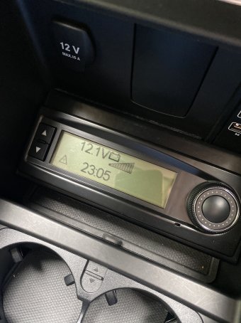

Thank you for your response. The roof started to raise thanks to your advice but stopped after a few inches with the battery sign flashing. The battery bars are not filling no matter how long I connect the lead to the side, also taking it out for a drive.

Should have some bars on it and I think it has a symbol showing the mains is connected and charging, in top right of the display. You need to check the circuit breaker behind the passenger seat is on (blue switch) to charge the battery.
