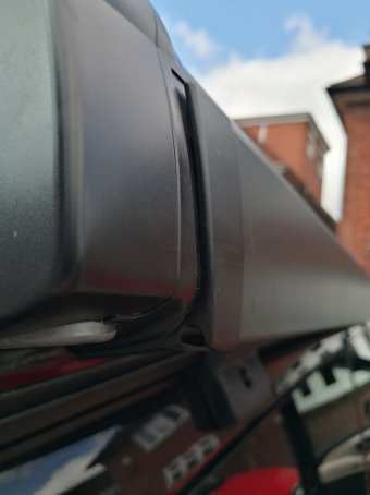

At the risk of turning into a spammer, I have another issue I'd like opinions on.
The front of my awning casing isn't closing up completely. I've attached pictures below.
You can see that it's marginal, so not critical by any means but it's annoying and does lead to water ingress, which inevitably then drips down the drivers door.
I've tried winding all the way out and back in - there does seem to be some unevenness in the fabric which I guess could be causing it, but I wasn't able to resolve this simply by winding fully out and then back in. I've also applied silicone to the lower edge of the casing in an attempt to get the flap to slide up over it and seal but to no avail.
So I'm wondering, is this normal? Do those of you with factory awnings find the same or do they close neatly? And do you have any experience or tips on how to deal with the issue?
Many thanks
Phil

Anyone got a chance to have a look at this? I've some tinkering time over the weekend so hoping I can resolve it... If indeed it needs resolving! Thanks

Sorry for the late reply, mine is similar, not a flush close but its solid and doesn't rattle.

Thanks Steve.
No mine doesn't produce a rattle either, just not quite 'so'.

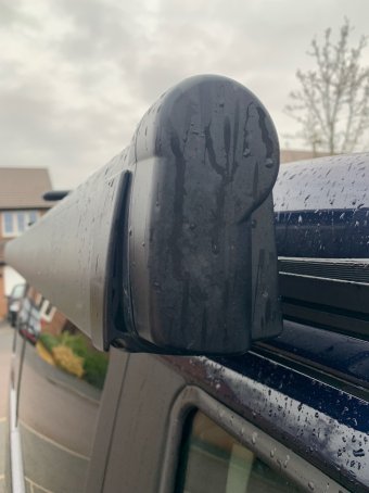

Drazil
Mine has the same fault and mercedes are doing a warranty claim for a new one as its bent. This is why it wont close on mine.

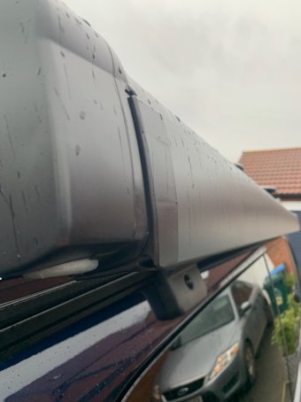

Thanks for this. Looks just the same if slightly more pronounced.
Can I ask is the vehicle brand new? Having had mine 9 months or so I'm wary that the dealer may try to blame misuse if it does turn out to be bent... Although it was in fact like this from the off.
Drazil
Mines a 21 plate 11 months old and I reported at about 7 months old. The problem is it wont seat correctly and rattles, also if its not securing safely is it safe is a question to ask.
